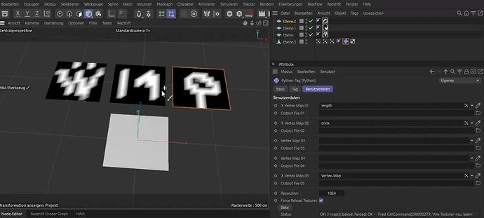

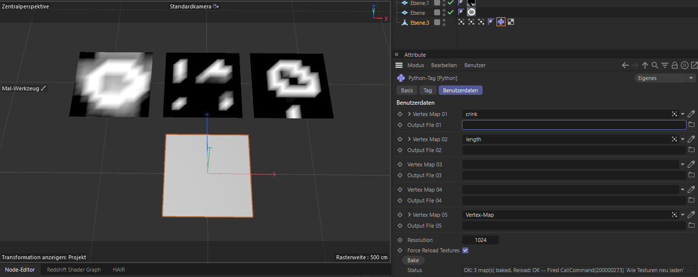

Und noch ein Script: Vertexmaps to Textures:
(video im link)
This handy little python tag lets you define up to 5 vertex maps on an object and let them get autobaked to textures.
It features a resolution selection and an autoreload function.
You can define the exact filepath and name where the texture should be baked/updated, but the default is the scenefile root>tex>scenefilename_objectname_vertexmapname.
